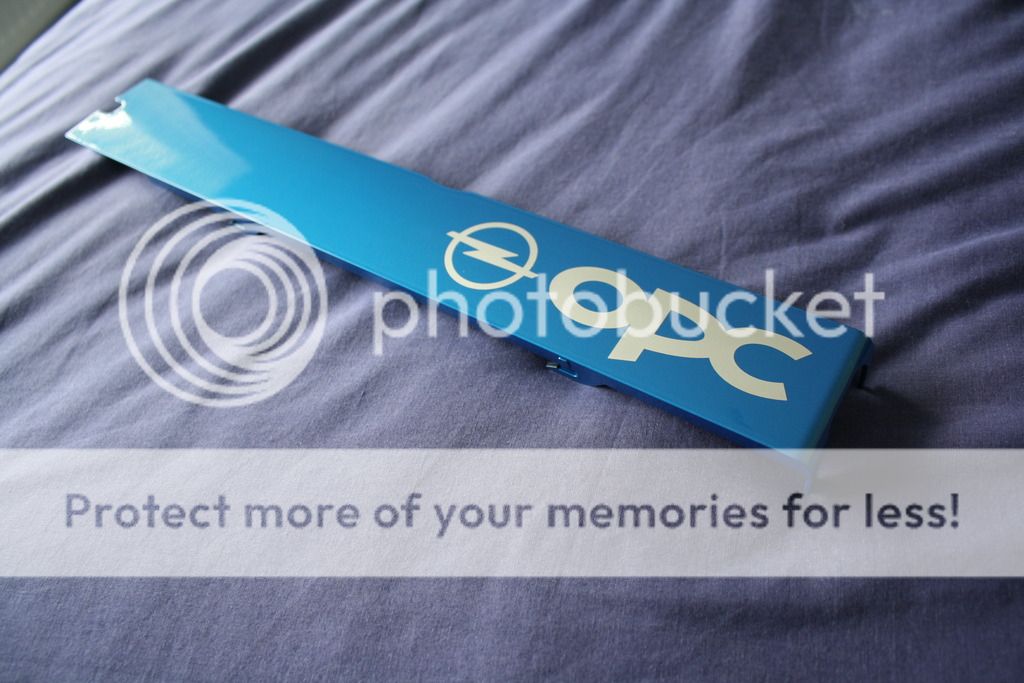

And the most important part of the engine
50,213 Posts
Win :D
