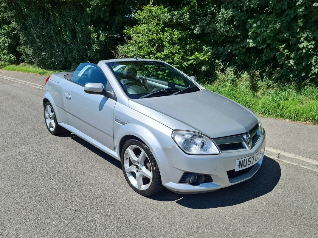

This is my progress thread for my cheapo Tigra, just a little project to get the last out of summer.
DETAILS
TIGRA (B) TwinTop
1.4 Exclusiv

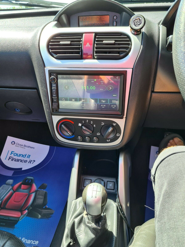

Aftermarket Android "7 Multimedia Headunit

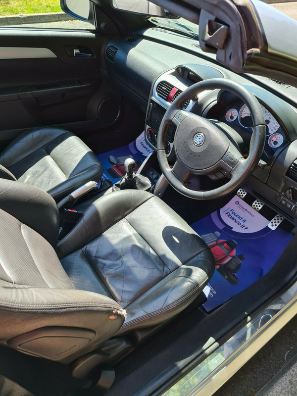

Sticky to touch Handbrake Handle - (Cleaned up fine but I would like to replace it)

Headunit Sloppily Fitted

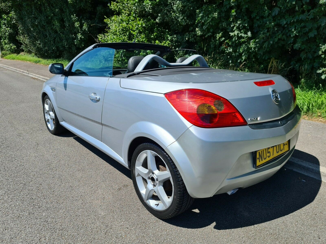

Both Rear Lights are cracked

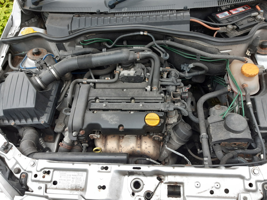

Spark Plugs
Replace Missing Engine/Spark Plug Cover

How are the leather seats holding up? Got the usual seat belt rub on the driver's side bolster?
72 Posts
Discussion Starter #3
Of course I do lol, just the way it is with seats.

I am getting conflicting Spark Plug and Oil Filter part uumbers on EuroCarParts, for my 1.4 what size filter and spark plugs do I need?
OEM part numbers would narrow my search or any recommendations would be appreciated, I usually use NGK Platinums on my fleet of ROVER's.
I also need a replacement Spark Plug Cover, its not important but I would rather have it. :giggle:
I have found one that I think is the correct one on ebay but a photo or part number would be great.
If anyone on here has one going spare too let me know.

Oil filter will be the shorter, fatter one of the 2 listed. I only get 1 option for plugs on ECP. You should try Autovaux as genuine parts are often cheaper than aftermarket from them.
Fuel filters are simple if you have the correct release pliers for the clips on fuel lines. Soak with wd40 first as they probably have not been moved for several years! The plastic can get brittle but new filters should come with new clips.
The coil cover will be the same as the Z12XE, Z12XEP engines so should give you more options.
