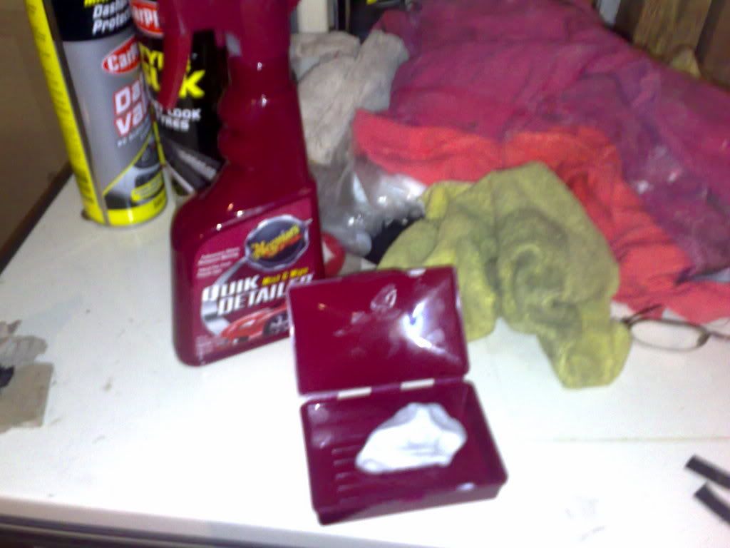

in the pack you get these 3 -
As you can see my cloth is quite dirty i do appologise!

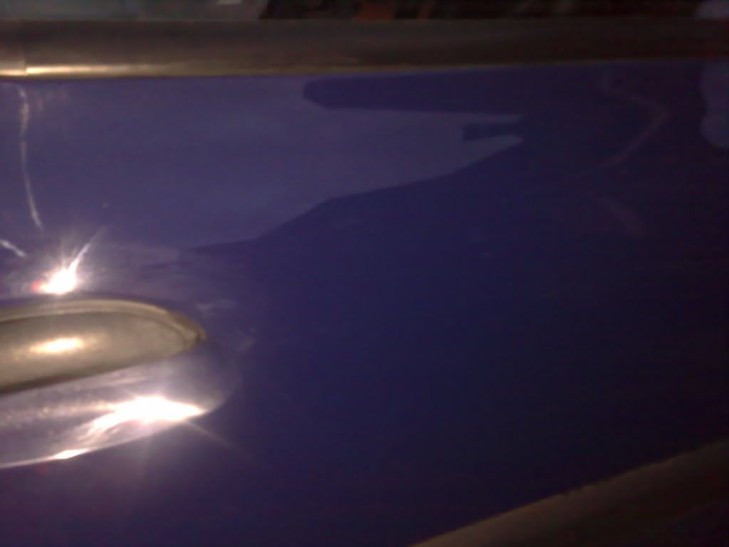

1st take one car in this case a lovely purple clio
wash your car make sure all the loose dirt is gone!

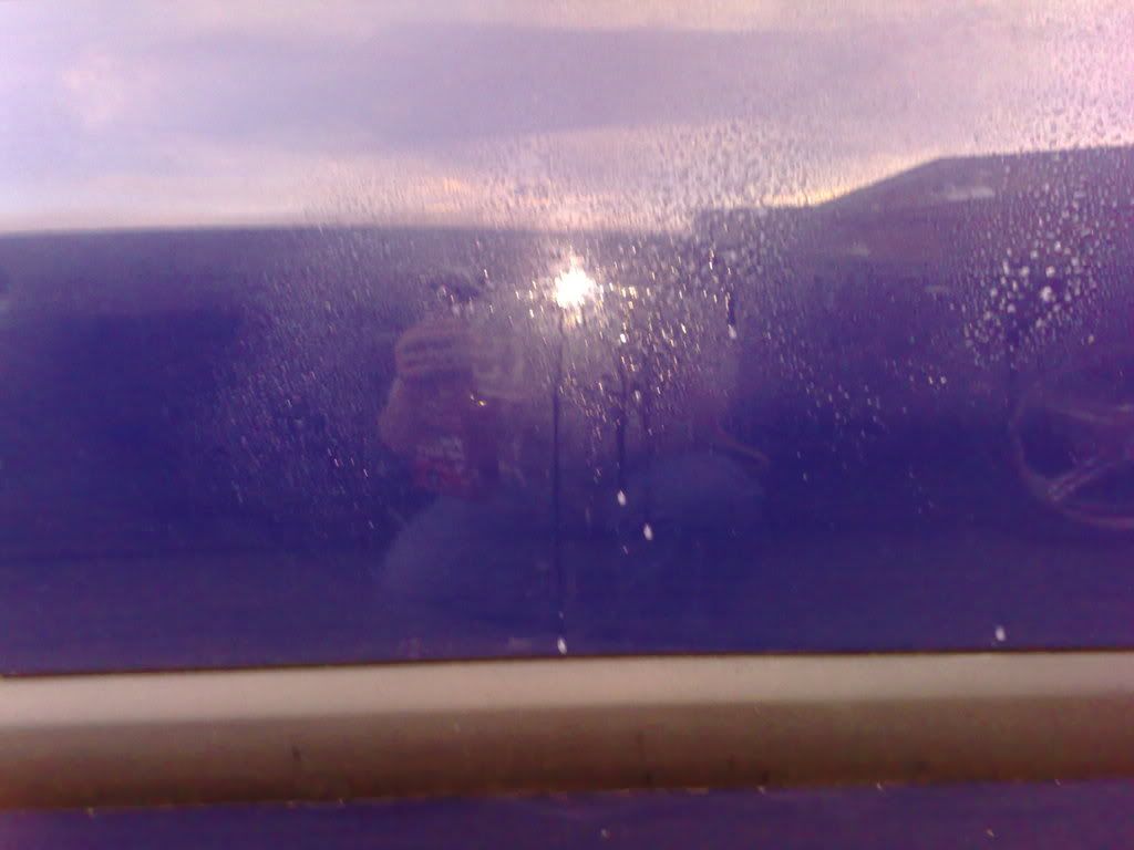

Then its time to go crazy with the detailing spray if you put clay on a dry spot it can leave nasty marks so make sure you put plenty on this clay is that strong so dont panic too much about ruining yor paint just try to keep the surface your claying wet with the detailing sprayand its best to do a pannel at a time or it will just dry up!
Then get the clay out and rub with a tiny bit of presure over the area you have just sprayed!

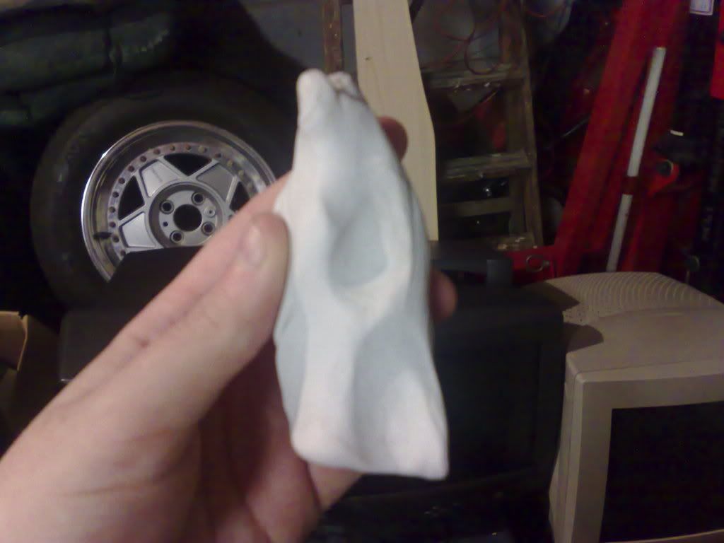

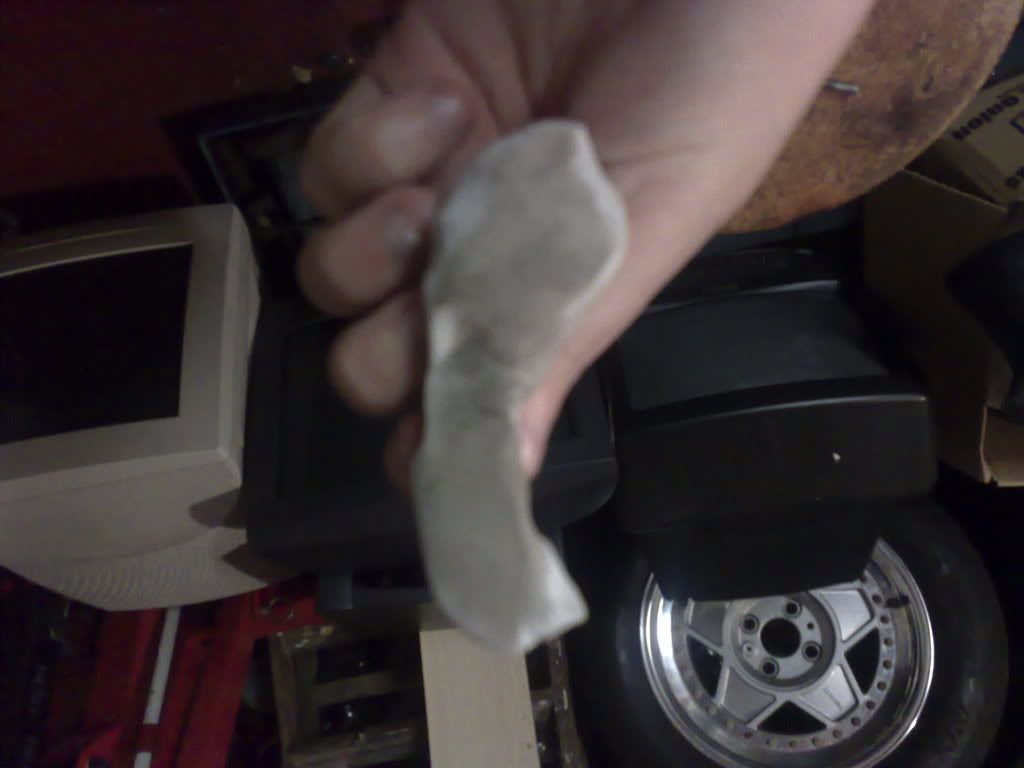

to check its working keep looking at the clay your using to see the dirt its picking up
and when it gets too dirty remold the clay till its clean and carry on

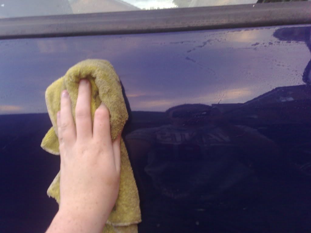

once you have rubbed the clay over the area you should be left with beads of detailing spray left over
this is where the microfibre cloth comes in! wipe it all dry (you will need a bit of strength or maybe thats just me being weak!) with the cloth making sure you get all the spray!
my hand looks really fat and weird in this picture sorry!

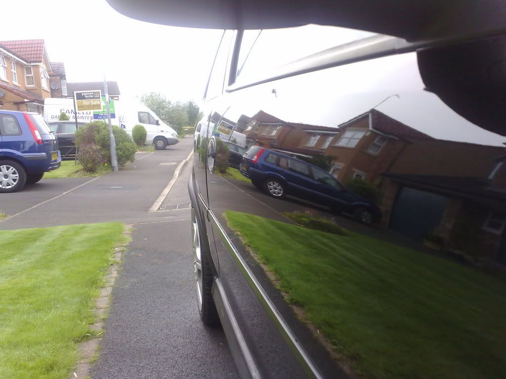

then admire
wash your car again then wax or polish and wax!

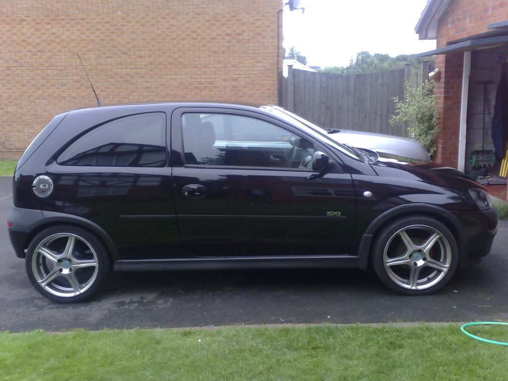

i wasnt doing all my sisters car because its £22 a set but heres my car with it all done -
