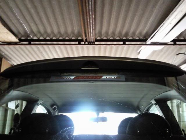

lift you boot up and locate the 4 star fitting screws
2 there and there is another 2 each side

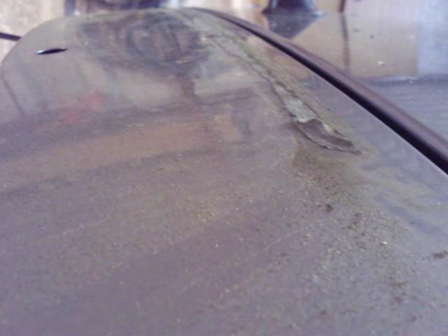

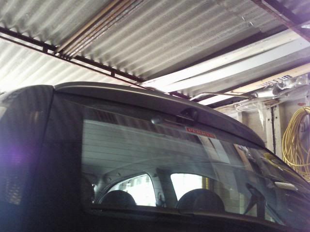

the spoiler should be loose but will not come off so you need to use abit of force and pull it off. take your time because it is held on by double sided tape which is very strong. once off should look like this

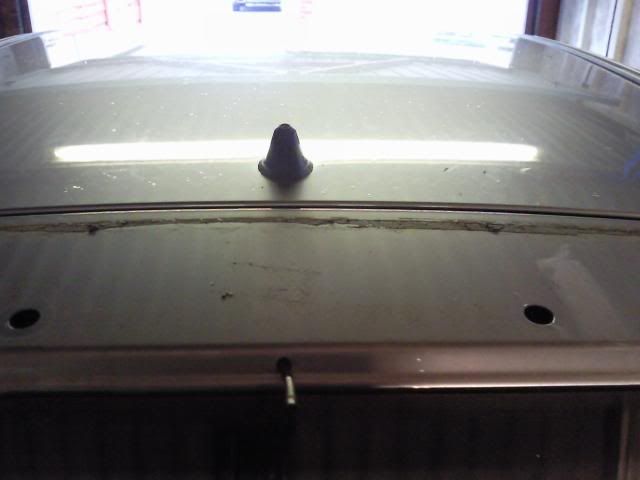

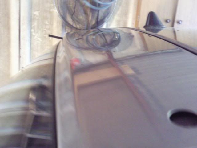

you need to remove the stick stuff and the dirt so i used white sprit, rag and my studend card from 2008 which i found:lol: (new it would come in handy one day)
takes along time to remove it all. when done should look like this

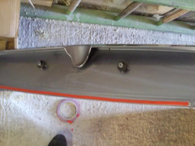

offer the spoiler up to see where it fits so you know where to apply the tape like so
Step 7
apply the tape and the rubber washer things which are supplied

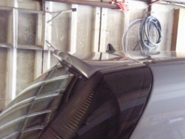

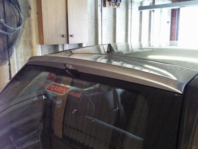

line the spoiler up on your boot and press down
Step 9

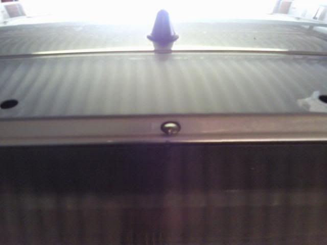

lift the boot up again and tighten the screws which you took out n step 1
then your done
Step 10
stand back and edmire your handy work
