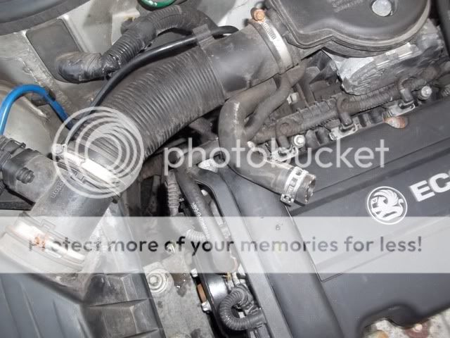

1. Take off expansion tank cap
2. Back of heater matrix, follow these two pipes to where they meet the engine block.
3. One here
4. The other here
5. Make sure engine is cold, doing this part. Don't want to get scalded from the coolant.
Using wide nose pliers or pipe grips, loosen the clips holding the pipes on.
You may have to ease the pipe off with a screwdriver as your doing it.
When the pipes come off, coolant will spill out from connection.
Catch with tray or absorbent pillow.
I covered the electrical connections with cloths to protect them.

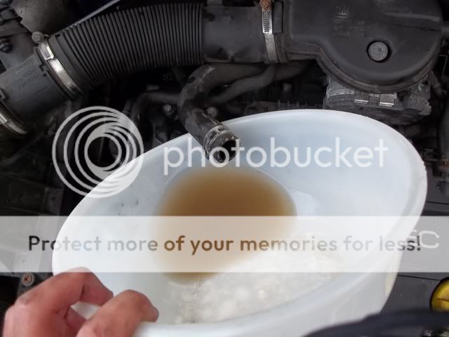

6. Using the nozzle from the water hose, insert it into one of the pipes.
Using a spare piece of hose, i inserted it into the other end to direct the water away from the engine.
7. When ready, open the water hose to flush the heater matrix.
This is the colour of the coolant as it came out.
Keep doing this until the water is clear.
The flow of the water should improve, the more it gets flushed.
Then change the water hose to the other side and do the other pipe.
This is when i realised, why my heating wasn't working.
I only flushed the one pipe and not the other.
The amount of gunk that came out was unbelievable!!
Once done, the flow of the water should match the other side.
If it only trickles out, the matrix is still blocked/clogged up.
3. One here
4. The other here
