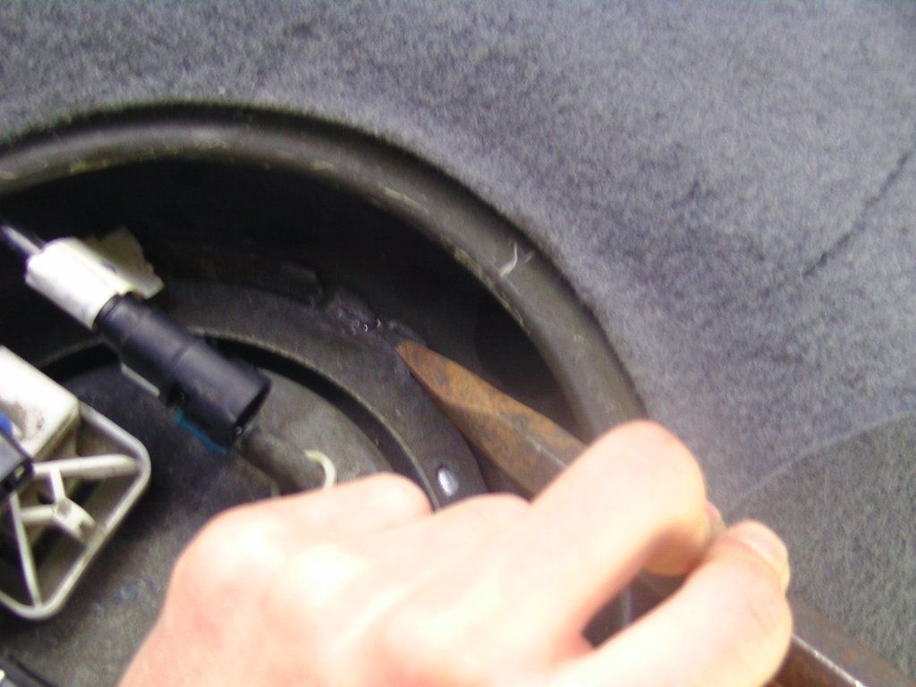

Jam a screwdriver in underneath the metal tabs that are surrounding the access panel and pry them up a bit, don’t bend them right up, but enough to slacken the tension off a bit
Now you can either use a metal chisel or a screwdriver for this next bit, I used a metal chisel as it was bulkier and I used a lump hammer as well to get that extra wack

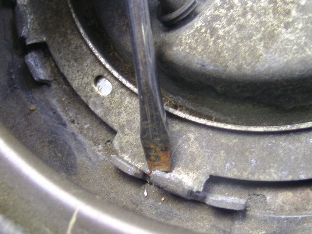

Hit on the side of the tabs sticking out of the metal ring and push the ring anti-clockwise
You can also put a smaller chisel or a screwdriver in the little holes on the flat face of the ring and push it that way, which you can see next to the screwdriver in the previous picture
This takes a lot of time and effort but keep at it and you’ll get it off

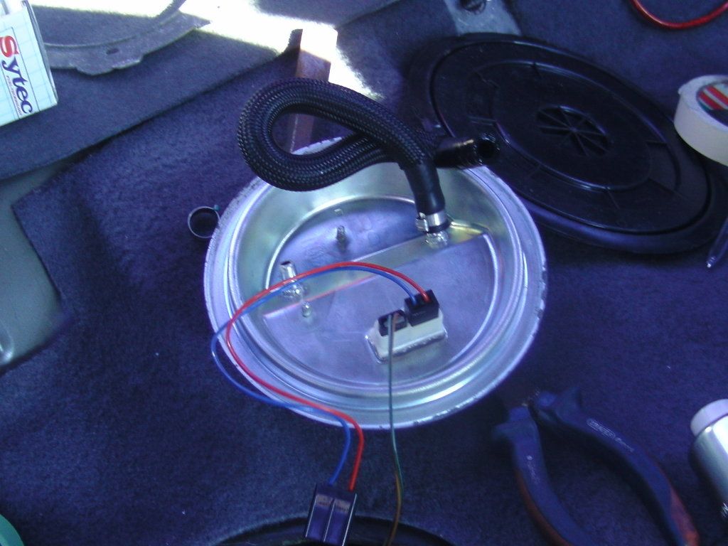

Underneath this, it will look something like this
Now pull the connector off the old fuel pump and make sure it fits into the walbro, if it does happy days it’s plug and play, if it doesn’t then you’ll have to do some cutting and soldering, but as long as you get a Vauxhall corsa kit, then it should be plug and play
Now you have to faf around getting the connector back out the walbro, which takes a bit of messing around with a screwdriver, but you’ll get there
Undo the fuel return line from the access panel and tie a piece of string around the pipe so that you don’t loose it in the bottom of the tank
Also undo the fuel feed hose from the fuel pump, both these clips require you to pry them off with a screwdriver, so be careful not to drop the clip into the tank, otherwise you’ll be fishing around with a magnet for 30 mins trying to get them out
I replaced them with standard jubilee clips as they are much easier to work with
Now you can more easily move the panel around and get it out the way (I didn’t know how to get the fuel level wires out, so I left them and got the panel as much out of the way as I could

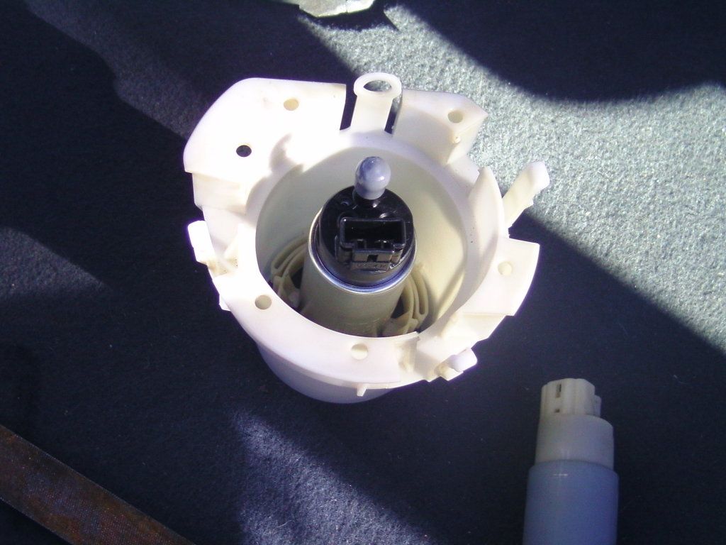

Now you can dissemble it to get these three parts
You have to squeeze the clips in which are circled below, then you can pull the top off, and pull the pump out
You have to trim these parts so that they can fit over the pump properly
Slot it all back together with the new pump
