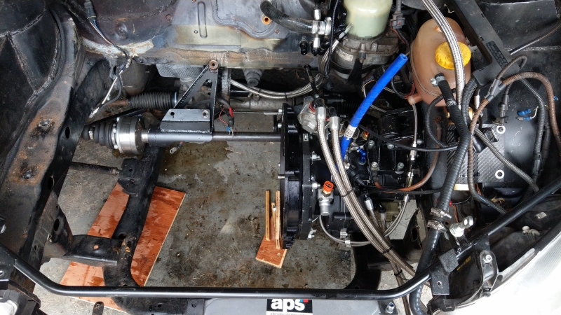

Yesterday I removed the remains of the engine, that's a tight squeeze with the gearbox still in situ.

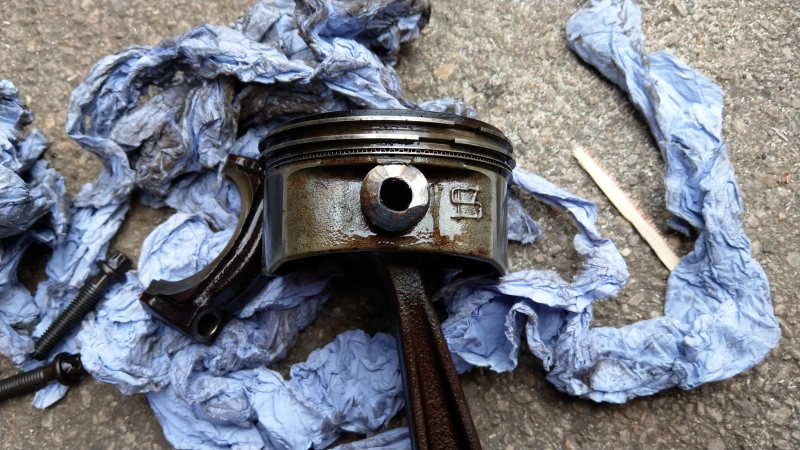

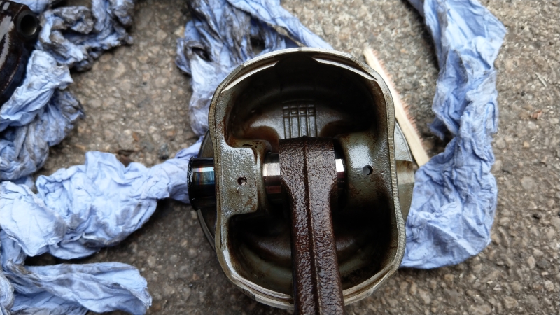

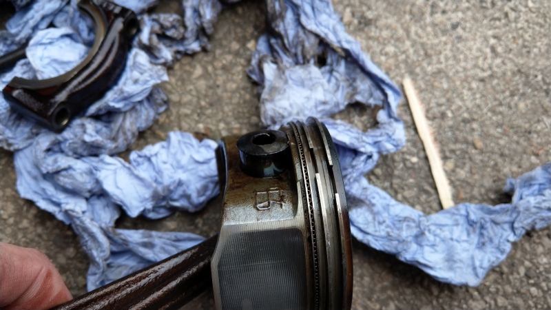

Then pulled out piston 1 to have a look and was surprised to find the piston hasn't failed, the pin has walked out of the conrod into the bore, also mangling the rod and crank due to the thrust load. If the engine had run hard any longer it would have probably broken the piston as there is only 1-2 millimetres of pin in the opposite side.
