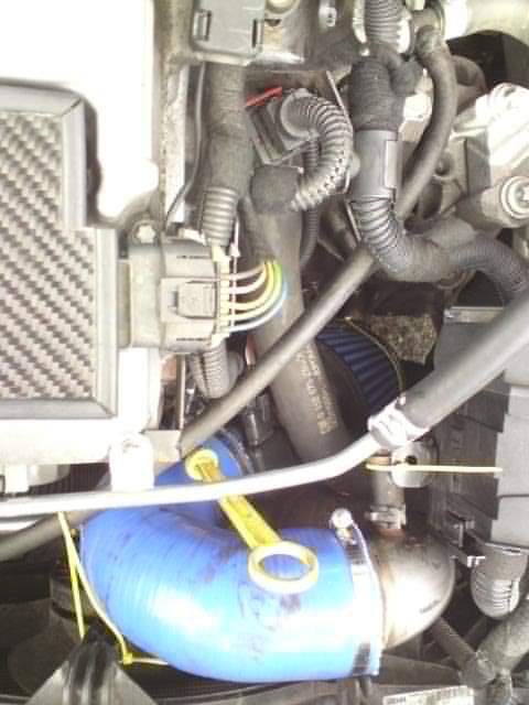

so, as you may or may not be aware i converted my tuned Z18XE engine set up to turbo power in an evening with the help of Warren G, managed to finish by 1:30am, all fitted minus an air filter, the dump valve, boost gauge and a fair bit to tidy up...
its been a week and a half since we fitted it all, and its been a bit of a work in progress since....
heres some photos once finished:
Since that Friday evening ive been tinkering here and there trying to tidy bits and get the car running 100%...
so far ive fitted the dump valve set up, had to modify the intercooler pipework to get it all in snuggly (as i wanted to keep my aircon) the re circ part of the dump valve isnt fitted yet as the vacuum pipe needs to be routed in to the inlet - this means removing the inlet and drilling a hole... (job to do!)

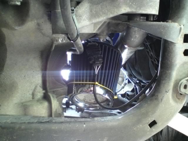

Ive relocated the air filter to lower down in the engine bay, as you can imagine the tubby creates a fair bit of heat..
heres how the filter set up looks now:

ah good idea, that hose is a bit gammy tbh! ideally instead of having the loop i want a straight metal pipe going in to the turbo, then the MAF and the a bend for a cone filter which will snuggly fit behind the nearside foglight grille ;)

:| nath
please
please
please
tell me that isnt your filter
this far |-----| from the floor
as if it is
*crosses heart*
dont drive even if its damp :|
its not that low matt, its around 30-40cms off the floor :)
phone camera doesnt help...

true, nice positioning, however, if you put it back where you had it, i doubt it will get warm with the size of that fookin huge cooler :lol:

whats your opinion jack? as mike and matt reckon i'll suck in water?
wont be a fooking huge cooler for much longer though, and where it was, the filter was squashed in and the silicone hose was wedged against the dipstick even when the dipstick tube was undone and bent...

yes it will :lol:
oh... :woops:

If you are slammed on the floor it then may cause problems, i think it might be ok depending you don't hit any big puddles.

personally, same place however, chop the metal pipe so instead of it going from the left to the back,
it comes Up then to the back with a 90degree piece?
but yeah, may suck up water:(
