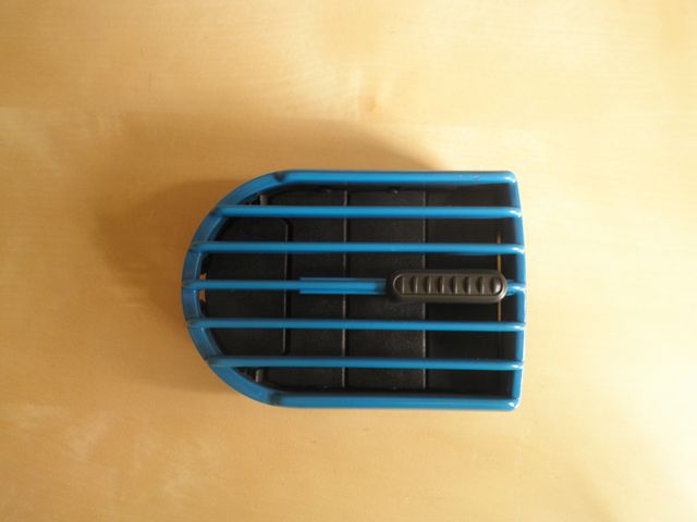

2. Take the vent out, that's how it looks like

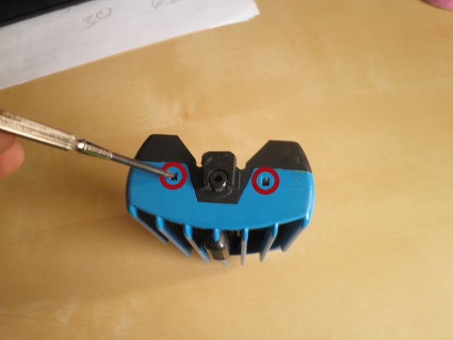

3. To split the vent you will need to push in to clips circled below with your screwdriver

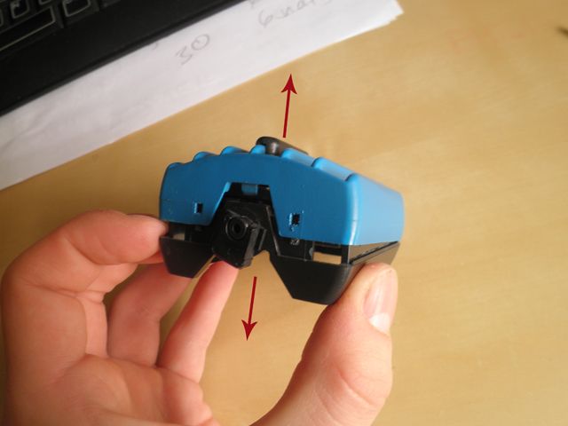

4. Now that you pushed in the clips, carefully pull the vent pieces apart as shown below

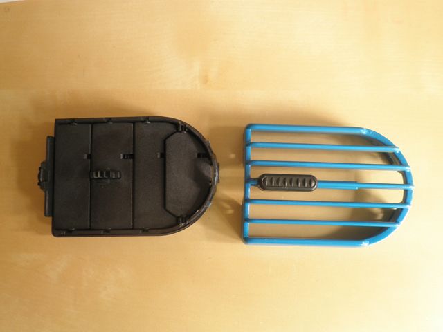

5. That's what you should have so far

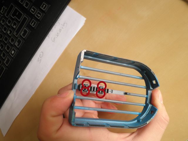

6. To remove the slider knob, push in four clips circled with your screwdriver

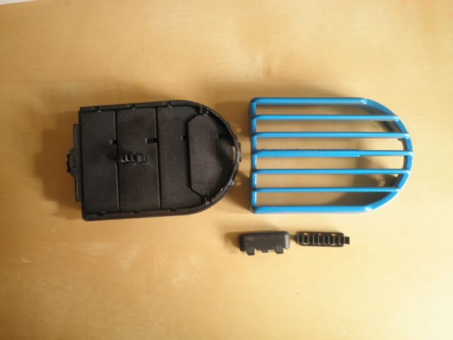

7. All done
