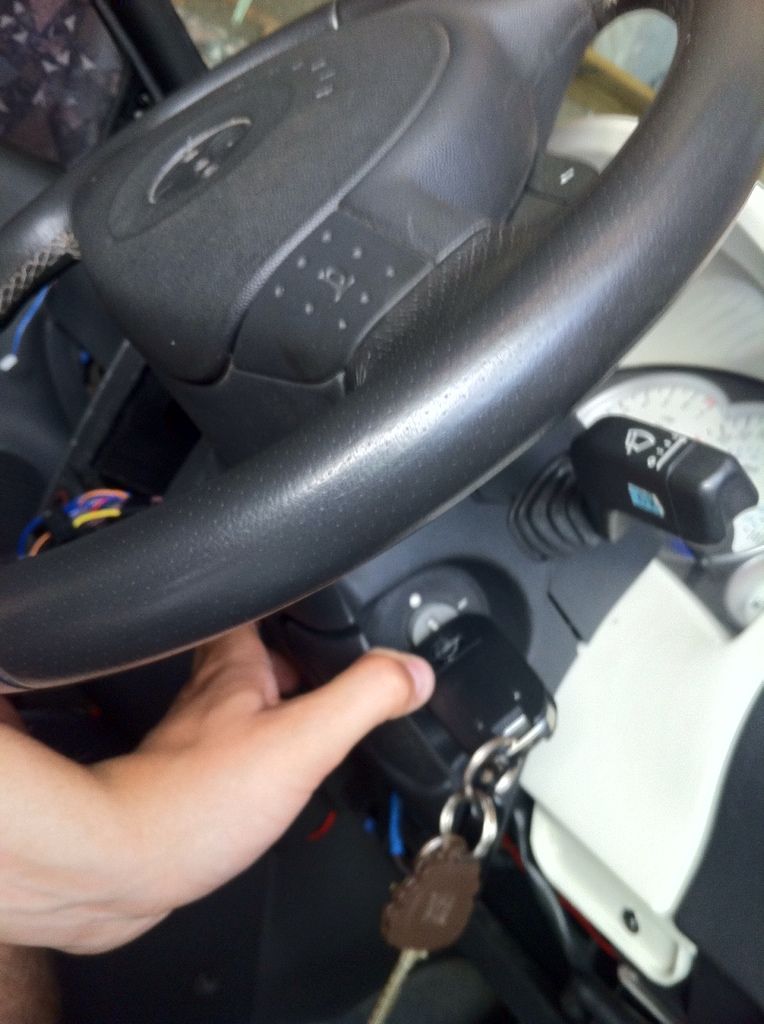

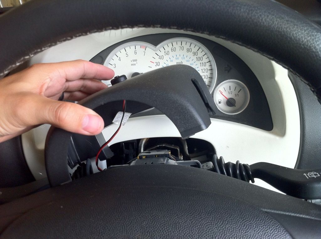

put key in the ignition (turn to 2nd position) to unlock steering lock turn steering wheel upside down & remove key while your there and if you have a tilt steering rack pull down on the lever where my thumb is
2) you should have the below looking threw the bigger gap of the steering wheel undo the screw with the t20 and pull off handle
3) now look under the steering housing and you will see a hole with a t20 screw undo it (it should just drop out)

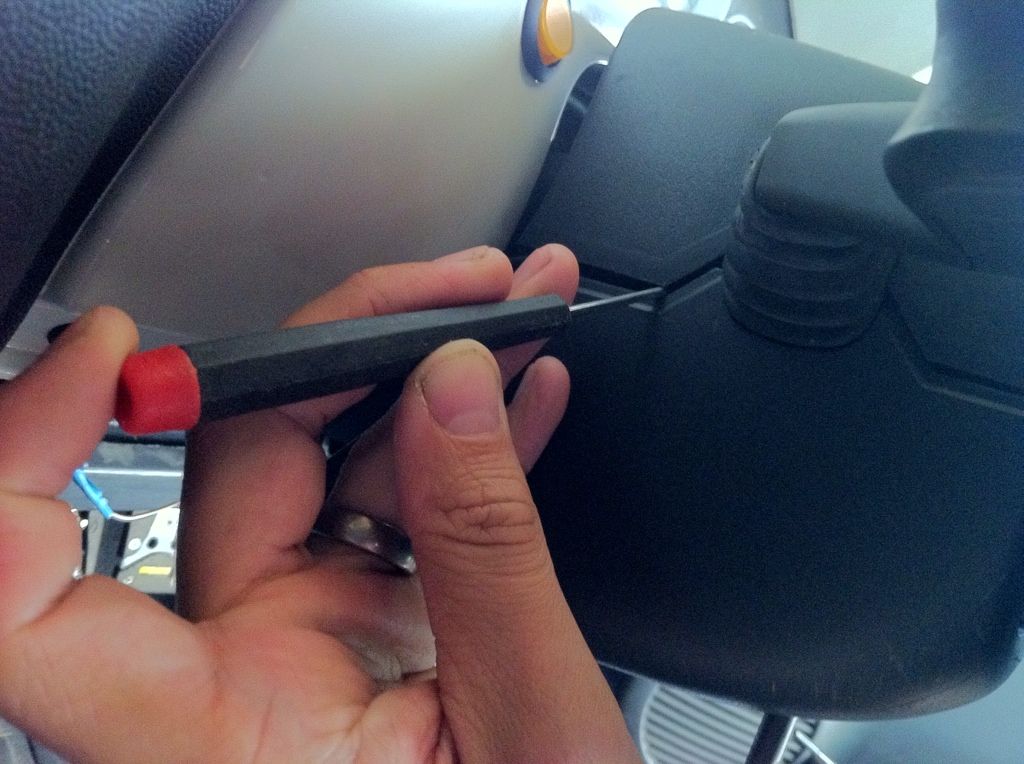

4) get the small screwdriver and prise top & bottom cover apart like so and pull the top cover up

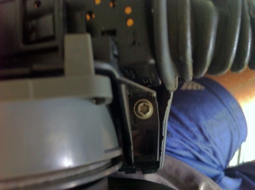

5) look down where the indercator stalks are you will so two t20 screws ether side undo and remove to safe place

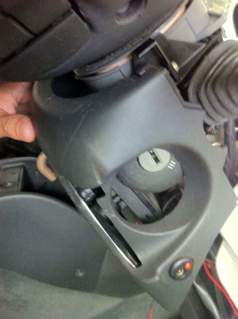

6) push handle you undid earlier back in to original position then pull down on botton housing

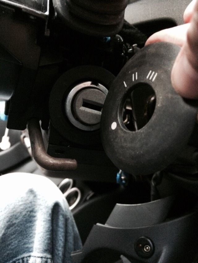

7) now pull off the barrel surround
8) next is to remove the indicator stalk, there are one tab at the top & one at the bottom push them both in & pull out
9) unplug the indicator stalk push the blue bit down & pull from the loom

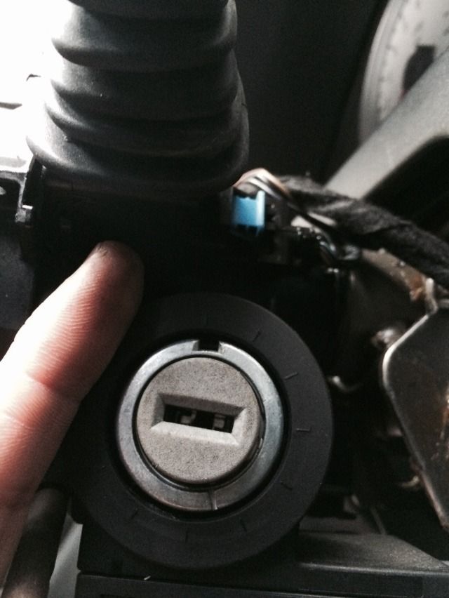

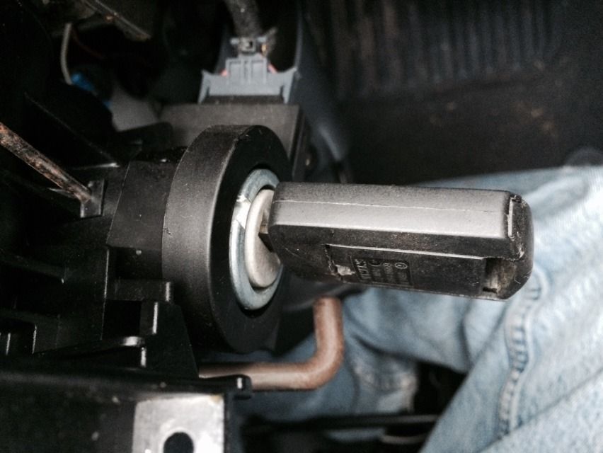

10) put the original key in to the ignition

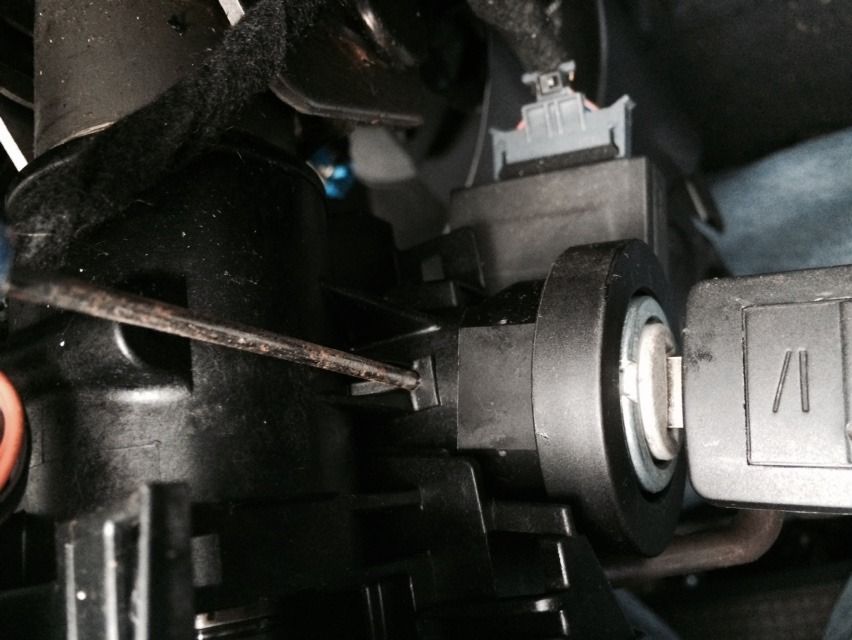

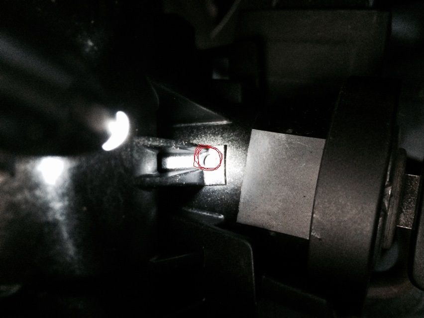

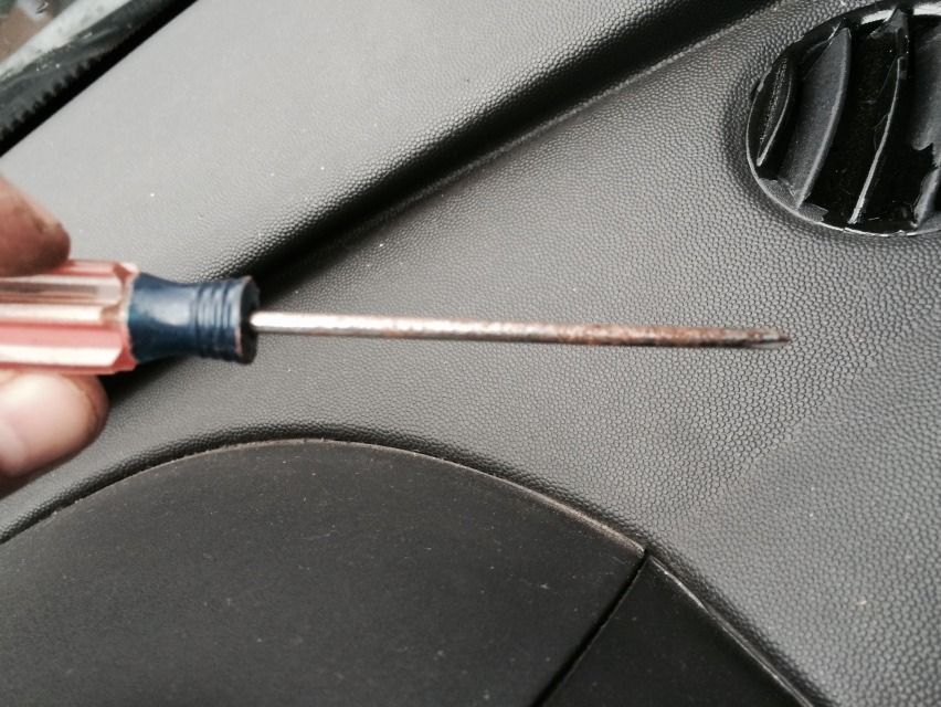

11) locate the hole (in red) and grab a small screwdriver
12) put the screwdriver in the hole & turn the key to the 2nd position
13) push down on the screwdriver & the barrel will pop out

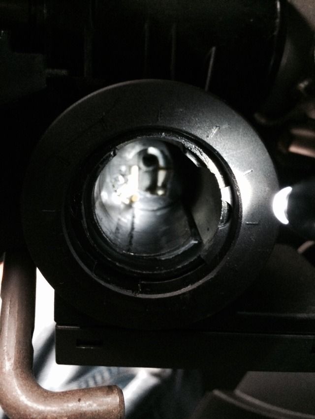

14) next get the flat head screwdriver inside where the barrel was & push the silver part in red down
so it looks like this

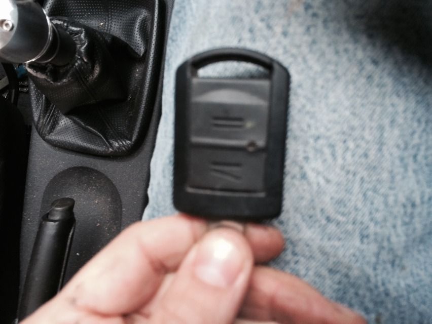

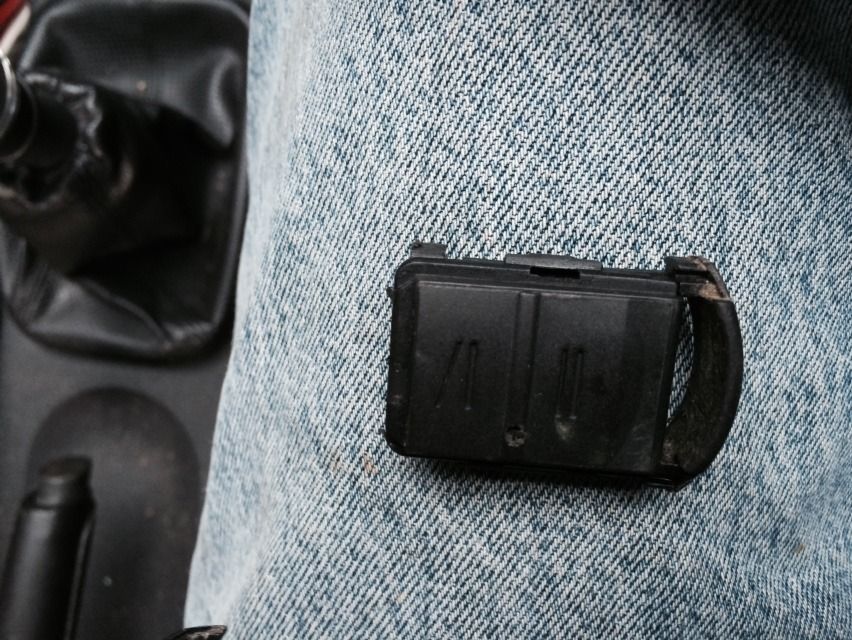

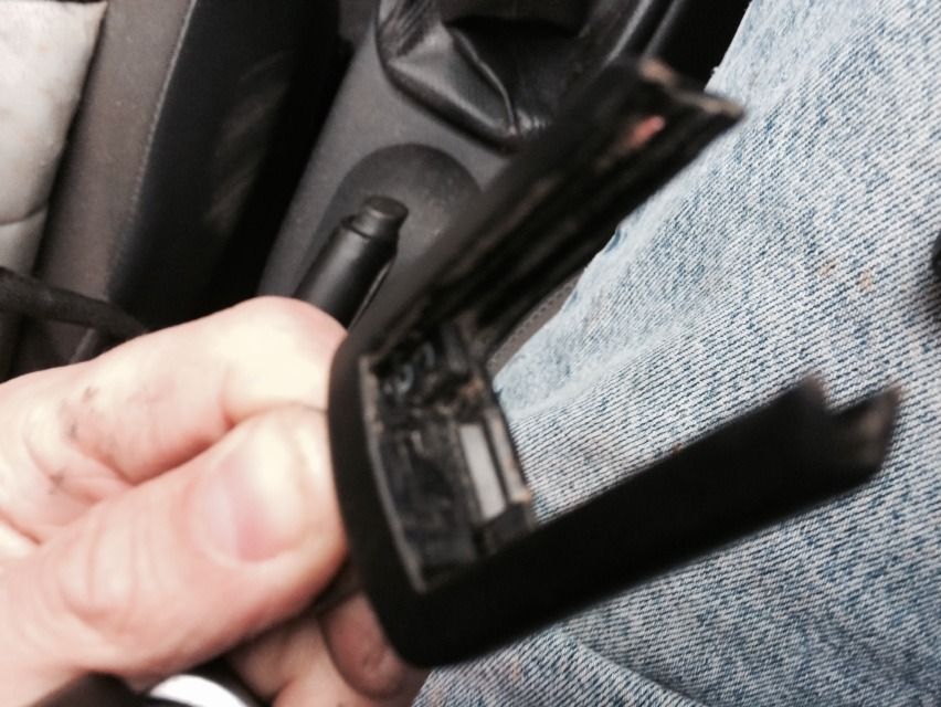

16) don't forget to remove the transponder chip/fob from the old key & put them in the new key
