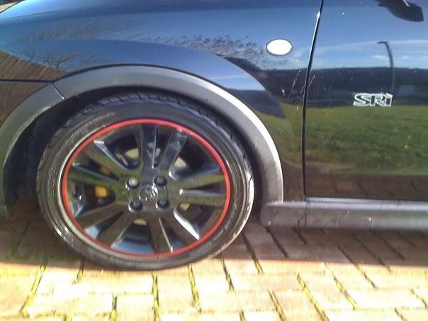

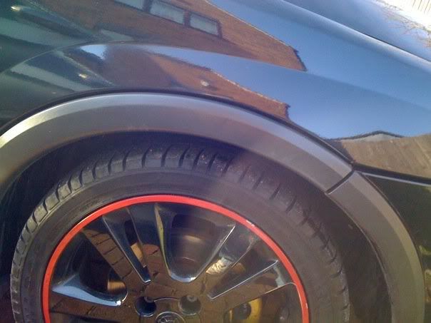

a while back i had a knock in my car well i hit a wall after someone pulled out infront of me i had the car repaired by my dads mate which works for himself. i have noitces when going over certain speed bumps that theres quite a nasty noise i only have 16 inch astra sri's on my car so shouldnt be a problem with the wheels. i looked in the arches and the passenger side(the side my car was smacked) the wheel goes up in the archs alot more than the drivers side is this a suspension problem?
thanks tom
passengers side
drivers side
sorry pics arnt very good as its just a quick couple off my iphone
would appriciate any advise thanks
3,408 Posts
it also looks like its been pushed too far back. bent wishbone? if hes replaced it, bent subframe?
810 Posts
yea thtas true mate im not entirely sure i dont have a clue tbf i definetly need it replaced though its annoying.
3,408 Posts
yeah get your wishbones checked mate, id bet good money he hasnt replaced one thats bent.
209 Posts
happened to me mate, looks like a bent wishbone
37 Posts
tbh it looks like a broken spring.....mine sunk the same when I smacked a pothole, I kept hearing a clattering noise over bumps.....the piece of broken spring on mine was clattering around the shock..
