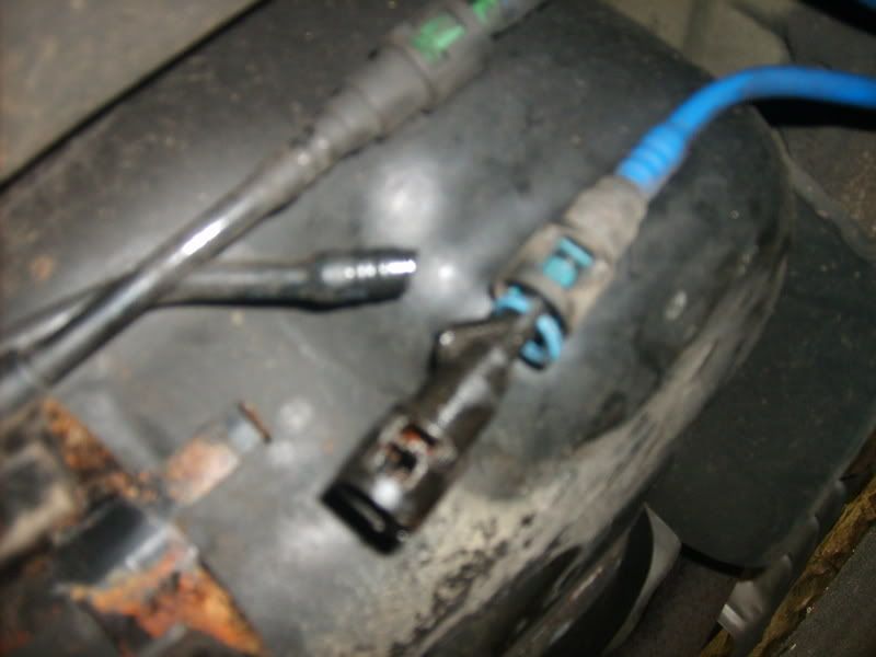

hehe just saw the other thread you got further than me but i couldnt get the right side clip off (towards the drivers side). One side of it snapped and just wouldnt budge gave up and put it back together and now it pisses fuel everywere 10x worse.
Gonna have to get it towed to a garage for them to sort it, i give up lol. Arms, back, legs and fingers are aching.
What a ball ache.
#7 ·
tell me about it my hands bleeding, im cold and now p*"sed off lol it was the front end that was the hardest to get off it eventually came off after some strugling looked and noticed that i had snapped one of the other attachments turned my engine on and the petrol poured out aaagggghhhhh!!!!!!!!!!!
does anyone know how much its gunna cost to fix?????
#9 ·
you will need a fuel return pipe now! thats about ÂŁ26 from Vx its a dealer only part iirc half hour labour to drop the fuel tank about 6 inches and wiggle it into place. The part youve snapped is non repairable needs to be replaced as a whole unit, i think i still have the part number somewhere if so ill post it up
